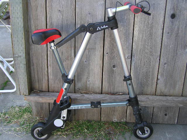

Postby elaine on Wed Aug 27, 2008 1:29 am
I have one that I just bought from a local. It has none of the markings discussed. Is it real?
elaine
Posts: 3
Joined: Wed Aug 27, 2008 1:12 am
Re: How to tell if an A-Bike is real or fake
Postby Nigel Kellett on Wed Aug 27, 2008 9:42 am
Hi Elaine,
Welcome to A-bike Central. :D
Looking at your photograph, it was very difficult to see anything physically different from a genuine A-bike, even down to the nuts & bolts. I instantly got mine out as a reference.
I am not sure whether you are based in the UK or not, but there are various cosmetic pointers, especially if so, as follows:
• The A-bike logo on the sides of the Upper Steering Joint (the top of the "A" shape) has a small TM after the e, and the dot on the i is red; both of which look to be missing from yours.
• On the Cross Piece (as in an "A"), there should be "Sinclair Research" on each side of the rear half, in capitals & on 2 lines, and "A-bike.co.uk" on the front half sides. It looks as though yours only has 4 various stages of unfolding on the rear half. If you lay your A-bike down from the position in your photograph, you should also find underneath the front half (upside down) a 7-digit serial number &, separately, a date of manufacture in the form YRyyyyWKww (e.g. YR2006WK28).
• On the back of the Rear Lower Tube (metal above the cranks) should be "Model No. ZB01 / Patented and / Patent Pending" (each of my added "/" denoting a new line). Actually, my Rear Lower Tube is an older one, having been replaced, so may be different, BUT the same should be true for the back of the Front Lower Tube.
• Your reflectors seem to all be correctly positioned, but do they have "Mayhem UK" or even "Sinclair Research" &"BS6102/2" on them?
• Finally, I think, there may be several yellow stickers, if they haven't peeled off. On the Handlebar Stem one showing an upside down triangle with a pinched finger & reading "Read manual before use" & "Max. weight 85kg 187lbs", both all in capitals. A no-step symbol on the front half of the Cross Piece ahead of the folding mechanism & button. And on the Brake Bands, a triangled exclamation mark followed by "Caution hot surfaces", all caps on 2 lines.
• Oh, and the tyres should read, amongst other things, "Cheng Shin Tire", "6x1¼" &" Max. inflate to 90 PSI".
Phew, simple but long-winded! :roll:
Hope this helps immensely. Best of luck. By the way, how much?

Postby elaine on Wed Aug 27, 2008 4:15 pm
Nigel,
Thanks so much for the quick and thorough reply.
I am in the US and have only two of the stickers you mention.
and
The 'Caution' sticker on the rear brake assembly.
It was practically given to me as the owner needed to move and the rear tube did not hold air. I bought it disassembled.
I could only find a tube that turned out to have a protruding 45 degree angle valve so I put that in the front tire and moved the front tube to the back.
This morning I put in air and off I went. Fun! Yesterday I was quite unsure as to whether I would keep it as the tire pressure was low (with the hand pump) and the ride was difficult.
The man who sold it to me said he paid 90 US dollars plus shipping. I will ask him where he ordered it...I do hope it's authentic.
Elaine
elaine
Posts: 3
Postby Nigel Kellett on Wed Aug 27, 2008 9:58 pm
Hi Elaine,
Hmmm, the price he paid seems suspiciously low, if brand new; it should have been more $300-$400 plus shipping, depending upon the rate of exchange at the time & when. I bought mine 15 months ago at £150 from Mayhem at their office, whereas previously it had been £200, as it is again with the new plus.
Stickers are almost least important; how about any of the permanent markings matching up? Particularly the serial no. & manufacture date underneath the Cross Piece, or the model no.? If not, I'm afraid that it may very well be a fake, unless somebody else knows better, of course.
Assuming that the tyres (sorry, tires) are correct, and you have a shock pump (best with gauge), as opposed to an ordinary bicycle pump (which is almost impossible to use/maintain pressure on such tiny tyres), it really is probably the most important thing to check that the tyre pressure is 90psi. Anything much less makes for a much much more difficult ride.
Anyway, if it does turn out to be a fake, always make certain that everything is locked in place whilst in use, and please be careful; it may not be entirely up to the job. Visually it might be pretty convincing, but mechanically is another kettle of fish. If you really think it's fabulous, it may very well be worth considering investing in a new plus, which is what I shall probably do pretty soon. You are bound to think it even more fabulous.

Postby Amuro Lee on Tue Nov 11, 2008 9:05 am
elaine wrote:I have one that I just bought from a local. It has none of the markings discussed. Is it real?
It's a fake A-bike definitely.
