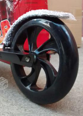

5.- Use good quality solid rubber for the wheels pls. Might be, an all plastic wheel, has no problem on the unbonded interface, between metal and solid rubber. Picture, of a sample wheel, attached.

all-plastic-scooter-wheel
